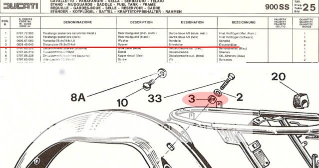

Hi, I am restoring a 1979 bike, number 146. I have a query around the small metal spacers that are used in the assembly of the rear mudguard.
The parts list and exploded diagrams I am working off show 5 distance tubes, the three around the rear numberplate holder and two on the rear indicator stem.
Then the lowest and closest mounts to the engine show two off the spacers listed above, I don't seem to have those from my strip and I can't find them with any UK parts supplier.
I have bought 5 reproductions of the distance tube, but can anyone give me the dimensions and maybe a photo of the part number 0628-49-040 Spacer that is used to mount the lower edge of the rear mudguard to the frame nearest the engine please?

Hi.
That part appears common to the 900SS and the parts book for that more (help)fully lists it as "Distanziale (Spacer) ø6,5 x ø14 x 4".

DM860SS_90003* wrote:Hi.
(From someone who spent ages flicking back and forth between the two parts books last year)
Hiya, can you help the uninitated with how to interpret the dimensions?
Is it internal diameter, external diameter and length - doesn't see right as 4mm sure isn't very long?
And that can't be right as it can't be 14mm outside diameter - that's a washer!!!!
6.5 internal is possible as the bolt that passes through it is a 6mm from memory so that makes sense.
So not sure what the 14 and the 4 stand for..........apologie for being thick...

Here's the stuff from the 1979/80 900SS parts book, Stuart (I've amalgamated the diagram and the description).
The spacer would indeed appear to be:
OD: 14mm
Length: 4mm
Can only guess the drawing is NTS ( 'not to scale') ...
(And 2 off, apparently ...)
OD: 14mm
Length: 4mm
