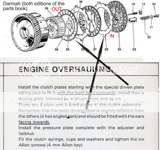

plates - anyone confirm the order for surflex pack, especially the friction plate with angled teeth? original clutch says its first, but noticed a thread on here says its last?

Cagiva Gran Canyon
Posts: 875
Re: changed clutch now no gears???
NeilD wrote:Plates - (can) anyone confirm the order for Surflex pack, especially the friction plate with angled teeth? Original clutch says its first, but noticed a thread on here says its last?
Seems that you're getting your friction - aka 'driven' - and your plain - aka 'driving' - plates confused, Neil :) . So, for your greater clarification, please see below, all taken from the parts book(s) and the factory manual:
NeilD wrote:currently with the pressure plate back on, if I pull the lever only the pressure plate moves - is that correct?
Yes. That's the only movement you will see. The plates themselves will stay all stuck together.
NeilD wrote:How can I test that the clutch is working correctly? I don't think it is, as i have the bike in gear however with lever pulled in the back wheel is still being driven (when I turn it over by hand)..
You won't get the plates to separate just by turning the engine over by hand. It needs the centrifugal effect of the engine turning at speed to make that happen. However, with the clutch lever held in, you should be able to induce a little movement between the plates using a little flat -bladed screwdriver or similar.
