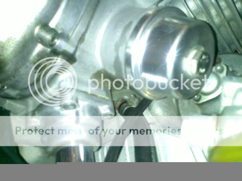

The 72 and 73 Imola race bikes had oil tappings for an external cooler (but not filter). The crank case tapping is just behind the front bevel tube and the returns are into the camshaft covers to increase oil flow to the top end.
I had the same setup on my 78 Darmah since 1980 but removed the cooler long ago becuase it just wasn't required for my riding. I've left the oil routing in place though, as it can't hurt having that oil in the demos.
Have a look at the pictures of the 73 short stroke on Phil Aynsley's site and you'll clearly see the crankcase tap-in position on the RHS pic of the engine. They cast some special cam cover caps for the racers, but you can just drill straight into them and the oil will be forced in through the camshaft voids and out onto the lobes (which is where you want it). Bear in mind those 750 cam cover caps are getting pretty expensive and hard to get now!! (I'm inwardly wincing at the thought of drilling one!)
http://www.philaphoto.com/imageLibrary/ ... =76&page=1
Here's my darmah arrangement so you can compare to your 860 cases
