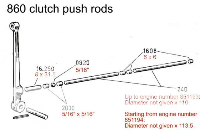

There must be a knack to replacing the outer spring box and keeping the bits from falling out, either that or i need longer bits or something is wrong.Tried heavy grease, and clutch center adjuster all the way in or falling out.

Put everything in place inSide the engine. The thickest piece that sits in the clutch actuator lever, that is greased up and stuck into the lever. Now bring the cover up and carefully put in place. Easy.

Hi Bob,
Check your components against this - the 860 rods are NOT exactly the same as the Darmah.
Also - and I don't know your engine number, so this may not apply: but I note that the long rods, 0759.16.240, were shorter before engine number 851194.
HTH.
Posts: 2168
Re: FAQ: clutch pushrod order info
Post by BevHevSteve » Fri Mar 22, 2013 8:48 am
Oh yeah Craig - you know that last rod is shorter on the earliest of 860, and, the clutch is different as well. I forgot about that....

I seem to have the later engine and the earlier shorter rods !, mine are 110mm when they should be 113.5 mm. But i don't see why i should not just use the earlier set up with the extra roller. I have a suspicion that a roller may have fell into the clutch center,and as the clutch is firmly stuck its comming to bits . Trying to work out how to unwire the starter ,looks like i may have to remove the rear light and mudguard first to get at the solenoid , Who designed this??.Shurly shum mistake.

Bob, I'd keep the balls and rollers as they are and get a new,or make a longer''bullet". The 3-4mm you need is probably from wear in the actuating lever. If run dry the bullet drills itself into the lever as the other end wears away.With a longer actuating lever you will probably need the extra length anyway because it will require longer travel to disengage the clutch[once you get it working of course].

Hi Bill, yes using Brancato Lever, and yes appear to be 3-4 mm shy. But suspect all not right at the clutch end ,soon be in there. --Later, found 2 rollers loose in the center,one is likely from my efforts, and a unlocked nut ,not very tight.No washers under the springs.
