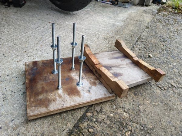

Here are a couple of bits of wood and threaded bar that have proved to be real useful. One for under the engine and the other for mounting a cylinder head on to allow it to worked on in the comfort of ones own home. Possibly on the dining room table ho hum...
The difficulty I have found with the engine support is exactly where the centre of balance is.

Kara: I use a small bottle jack and three pieces of wood, two strips that run front to back each side of the engine seam and then one under these between them and the jack.
Just a note: if you are ever contemplating head work, the motor can be dropped in-situ, leaving just the lower rear bolt in place. The casings have to be removed but that's an easy job:
