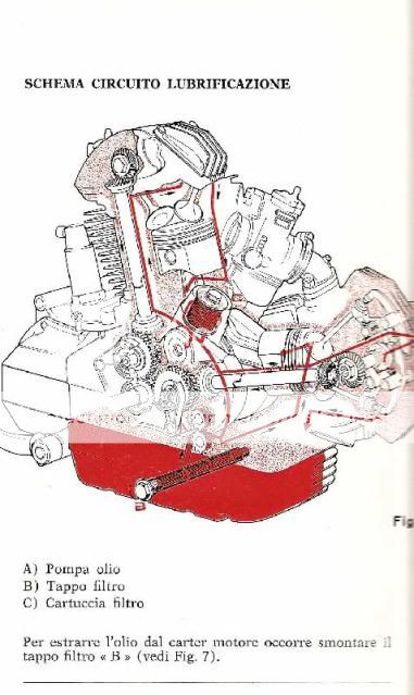

Bill's right: the oil filter - the one sitting in the housing on the top of the crankcases - isn't doing the type of filtering job that you might be used to. You see, not all the oil goes thru it all the time. Here's a diagram showing how the lubrication system works:
What this means is that you can't rely on the filter to pick up all the crud in the oil. Ducati used other methods to do this (for reasons I'll explain below), namely:
1. A coarse gauze mesh in the sump (the one on the end of the drain plug). All the oil goes thru this filter before being distributed around the engine. Btw, you'll see in the diagram that it is installed above the floor of the sump - and this is not by hazard :)
2. Centrifugal plugs in the crankshaft webs.
3. Frequent oil changes.
Of these, by WAY the most efficient is number 3 :vroom: . Remember the old adage: 'Oil is Cheaper than Bearings'.
(These days, there is 4th measure you can take. That is to get some rare earth magnets and stick them on the outside of the steel part of the filter housing. They'll attract and hold any steel particles circulating in the oil. You just clean up the inside of the housing when you change the filter. It's better than sticking a magnet on the end of the dip stick - altho' there's no harm in doing that as well.
And why did Ducati do this?
Because the engine uses roller bearings, not shell bearings. And what roller bearing engines require is oil QUANTITY, not pressure. Sticking in a full flow filter puts this at risk (for example: I own a Zané-era Laverda 750 with roller bearings in the engine .. and a full flow filter. And the first modification is to ditch the filter).
Only when Ducati went over to using shell bearings - basically, starting with the Pantah* and also on the last MHR MIlles - could the lubrication system be changed to high pressure/low(er) flow system. And, yup: these engines have a full flow oil filter because the one thing you must NOT have with shell bearings is contaminated oil - tears 'em up.
