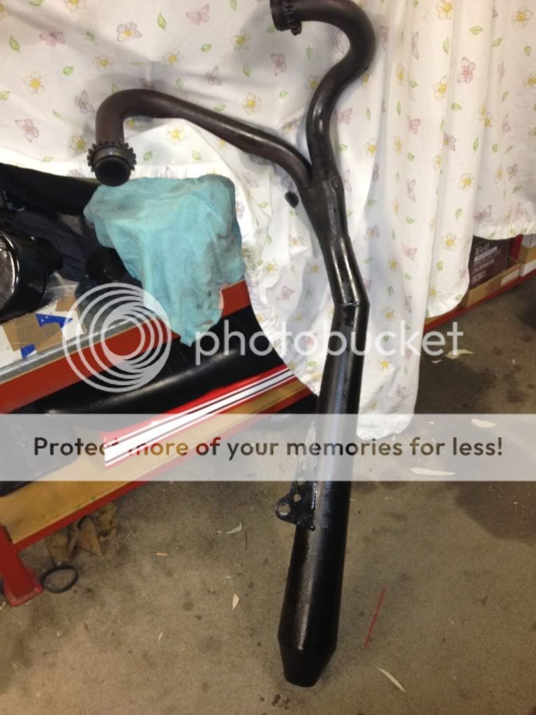

I had a Verlicchi 2-into-1 fitted to my 900SS. My wife claimed she could hear me six kilometres away coming up the river valley. Mine is a little different though. The headers and exaust can are separate parts. It is stamped 'riservato competizione'.

I've got a Conti 2-1 on my Darmah and it is pretty civilized. I can't recall ever seeing another one though,must be kinda rare.
