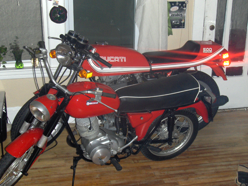

So I understand that things are busy, My Desmo hasn't been up and running since the 80's(before i was born)...Someone probably was busy from then til now...But Now here I am ready to pull the trigger on one of these electronic ignitions...I do hope to hear some updates soon, I have this itch and the only way to scratch it is by Driving The Desmo 5 I have been eyeballing for 2 years that doesn't run because of no spark and no hope...Please Help
