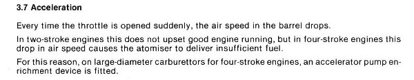

I added 4 litres of fresh fuel to the empty tank and could see that fuel made it's way to the float bowls via the the hose.
After giving the throttle a few twists to get the accelerator pumps to squirt a bit into the carbs, I noticed the carbs are dry. In other words, no matter how much I twist the throttle, the accelerator pumps are not squirting any fuel into the throttle bodies. The fuel bowls are definitely full of fuel.
Needless to say, the bike isn't firing (yes, ignition is fine with lot's of spark from the fresh plugs).
Question: After sitting dry of fuel for a couple of years, could something have gone amiss with the accelerator pumps? Or, do I need to add more fuel into the tank to provide more pressure since 4 litres puts the tank on "reserve".
Thoughts?
Thanks,
Herb...
2013 Ducati 1200S Multistrada
1985 Ducati Mille S2
1969 BMW R69S (Earles Fork)
Posts: 2214
Re: Won't idle
Hi Herb, you only need to prime the pumps.
Remove the non return valve, put a teaspoon or so of gas into the hole, put your thumb over the hole and pull the cable a few times until gas squirts out the pump jet.
You may have to pull the cable several times, you may also need to put more gas into the pump housing.
Repeat same steps on other carb.

The other non return valve.... it's on the top of the pump housing. ~^~
Cagiva Gran Canyon
Posts: 896
Re: Won't idle
Item # 54 in the attached drawing.

Thanks for clarifying and including the drawing. Nevertheless, I was successful in getting the front Accelerator Pump to squirt a bit of fuel in the body
when I held my finger over the hole (after removing the non-return valve). I didn't need to add gas in the hole.
So, got the bike running and warmed up. All is good until I let it cool, and noticed that the accelerator pumps weren't squirting gas into the body again.
Removed the non-return valve and tried the finger over the hole routine again but this time, no squirting gas. Next, I took the accelerator pump housing off the front carb and carefully pulled the throttle to inspect the diaphragm valve. The diaphragm appeared to be ok and looked like it was working - sticking out a bit as the slide ramp went up the cam. Blew out the housing and re-assembled and still no squirt.
Now, I'm thinking something is intermittently defective in the carbs. Could it be the diaphragm? I tried to remove the pump jet for inspection but after unscrewing the pump jet holder, I did not want to apply force on the pump jet as it seemed difficult to remove.
Anyway, it appears that my starting issues are completely connected to not getting squirts of fuel into the carb bodies. Something is stopping from the accelerator pumps from working reliably.
Suggestions on next steps?
