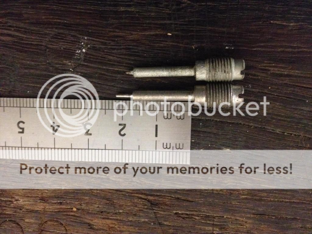

Steve is correct, there is another "jet" underneath the A series idle jet. There is one other potential difference...the idle mixture drilling may be different to accomodate a longer and different shaped idle mixture screw with the intent of provisioning some finer adjustment to reduce emissions. There may well be no difference at all in the drilling and it's all down to the needle, but might be worth checking.
CS/CD mixture needle at the bottom, AS/AD at the top.

Post by GeoffW » Tue Feb 18, 2014 3:23 am
Thanks Kev, I must pull out all the bits and have a really good scrute!
