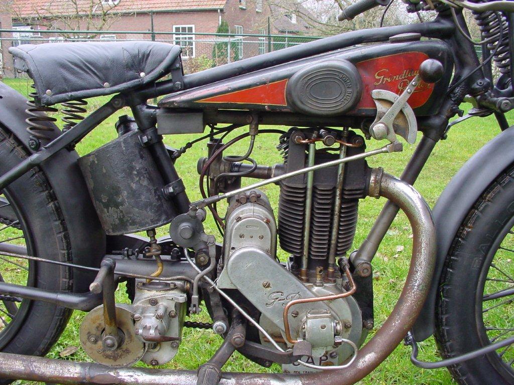

Well off to go look at a 1927 Grindlay Peerless that a guy wants to have restored. Job would be split between me & local Guzzi "Slicer" single owner Alan. It's like this one:

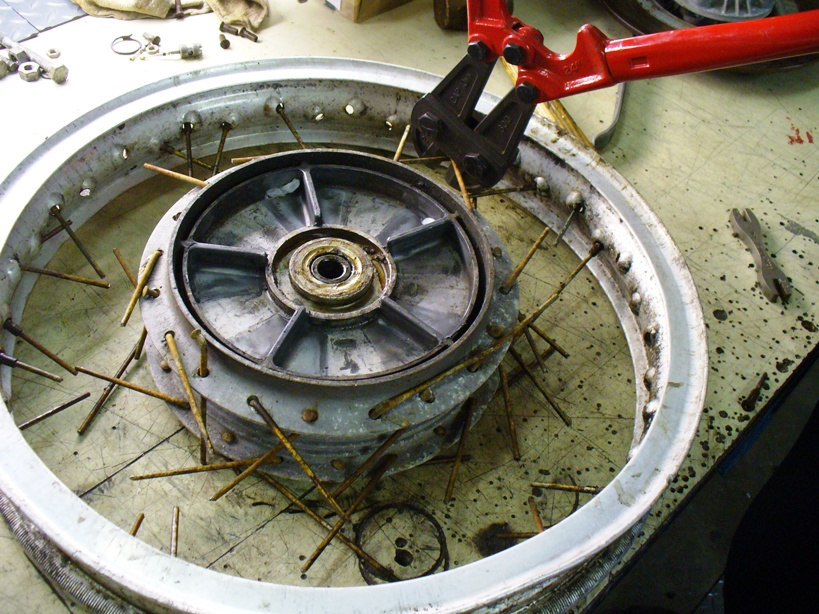

The front wheel came apart fairly easily, the rear one, not so much ............. well, OK it came apart pretty easily cutting the spokes in half with bolt cutters. Meh, they are both getting new spokes anyway.
A "new" Boranni front rim will replace the shoulderless aluminum one that was installed sometime in the past, probably when it had its front-end collision that bent the forks. Rear rim might be salvageable - much corrosion, tire iron dents and a minor flat spot. Green's Wheel Shop has worked miracles before so maybe ............... A new one is $200 US + shipping. If refurbing the old one approaches that, then I'll make that 2 new rims.
