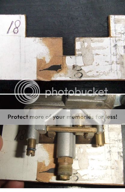

The only other thing I would add is that I have found it practical to make up a simple 'Go/No Go' gauge. Here's a photo - it is literally no more than a piece of hardboard cut out to the correct float height (18mm).

Sorry for the unclear photo......but it the float height gauge at 21mm as found.
