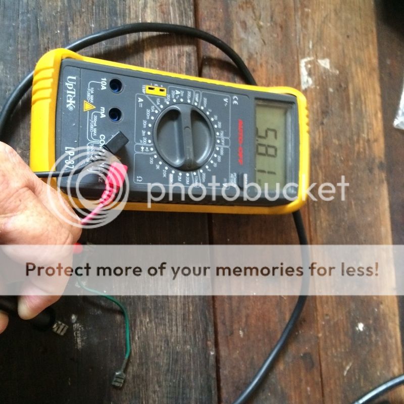

Here's my pickup unit...
Resistance one way on 20 MOhm test....open circuit...
The other way..5+ megaOhms on a 20 MOhm test...
I tested it with another gauge...same result. I didn't change it myself, so it is possible it wasn't working, but I'm pretty sure it was.

Thanks Kev - you're right, that's a really strange result. Puzzling.
Thinking back, when my unit had definitely failed there were sometimes "ballpark" resistance readings going open circuit within about a second and sometimes several megohms. Initially I thought maybe a capacitor somewhere in the mix, but on depotting certainly not.

Hi again Kev,
'Scuse me for asking, but what's the green wire connected to? It looks like a link wire of some sort with nothing on the other end?
Bill

Hi Bill,
It's not clear in the pictures, but one of the wires from the pickup has two terminals on it, with the tail wire the short green one. I'd need to have a look at the wiring harness to trace where it's going. It's not exactly clear from the wiring diagram as there appears to be three wires on a common connection to the CDI/Coil unit.

Post by machten » Tue Feb 03, 2015 4:55 am
Btw....I also saw when measuring a declining resistance from about 8MOhm before it stabilised which also looked like a capacitor in the circuit.

Post by Bill48S » Tue Feb 03, 2015 11:37 pm
Hi Kev - thanks for that, it's been so long since I've seen the "original" set-up I'd forgotten about the grounding wire on the negative lead from the trigger.
I gave away the road equipment on mine 20-odd years ago when I'd planned to make it a track bike, so connected that to a handlebar kill switch.
Now that she's back to road trim with an aftermarket headlamp , things are changing again :-) - including a Jaycar "transducer" as an alternative.
That "spike" and fade is a puzzlement though as there's definitely no capacitor there. Could the applied voltage from the multimeter be inducing an emf in the coil for a short time? As I've said, I'm no electronics engineer, so that's a total guess.
Bill
