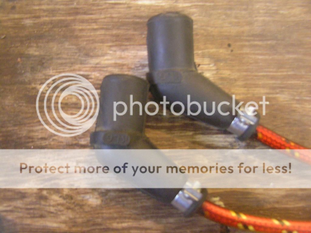

Apologies for the poor photo, but the red ones look like this...

I have some original pieces of the "red" wire and can confirm the above photo is spot on. They are really more of an orange than a true red color. You can buy repro but of course its nothing like the original. The green repro seems to be pretty close but then again I have never seen an original green sample in person.

I agree with the picture posted by machten. I have the KLG 45 degree ends and the original red spark plug wires that came with my 73 750GT brand new. The cable ends are still serviceable but the cables are not. No, they are not for sale, I just wanted to confirm what they looked like in the early 1973 US models.
