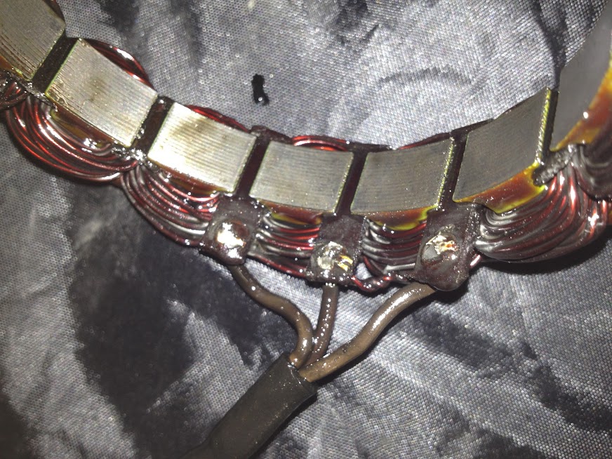

As per normal the winter has given me a little time to tinker with the bike. I took it upon myself to fix this wiring/ charging thing once and for all.
I cleaned up the wiring, changed a few things around and then I started thinking about the charging system. I have a new rotor that I will be installing but I am also thinking about the stator. The stator from the bevel is centre tapped due to the old rectifier circuit used. That means that only half the output voltage is used when rectifying in the original design. I found some comments by a guy name James de Raeve who wrote about this fix.
When using a modern bridge rectifier that only requires two inputs from a single phase stator. The excess voltage will just get turned into heat by the regulator. So why not modify the stator to use the coils from the center tap in parallel rather than in series. This will half the output voltage but it will double the current available.
Stator Before:
____|--------yellow(a)
\____
____|--------red
\____|--------yellow(b)
The following would be the mod to the stator
1.Disconnect one copper wire from the windings from the center tap.
2.Determine which yellow wire(a) and the disconnected copper from the windings form an open circuit.
3 Now attach that copper wire to the alternate yellow(b).
4. There should now be one copper wire left at the center tap from the windings this can be attached to the other yellow(a) 5. the center tap red can be ignored and that wire discarded
6. use these two yellow in a two wire bridge rectifier.
Stator After:
_______|--------yellow (a)
\ \ ________ center tap is no longer used
\_\______
-----------|--------yellow (b)
Thoughts? Downside other than wrecking my stator when I do the soldering.

We had record high temps here in Canada and I finally have had the Ducati out for a few long rides 'AT NIGHT' after the winter electrical mods.. The alternator mods were successful! I can run lights with no loss at about 2500 rpm with just the taillight(headlight off ) there is no loss at about 1500 rpm. This means city driving is a non issue now with the Ducati. Previously I would have to constantly recharge the battery. I have used up 3 tanks of gas of mixed city and highway, and absolutely no need to charge the battery so far. This was not remotely possible before. Battery voltage is a respectable 12.75 after a night time city ride using my headlight the entire time.
Mods performed
New rotor magnet.
Modifying the stator removing the center tap and setting up both sets of windings in parallel
Installing a modern two wire bridge rectifier/regulator
I will post pics and a detailed set of instructions and pictures and where to source the rotor and rectifier regulator.

Working great still with 2,500 miles on the bike this summer.
I used the stock stator however I modified it changing it from a centre tapped stator to two parallel sets of coils, as described in the first post.
Be very careful when doing the mods, if you scratch the coatings or break the leads you will need to get the stator rewound. The reason for the change in the stator was to use a more modern bridge rectifier.
Before
After
Bernie
