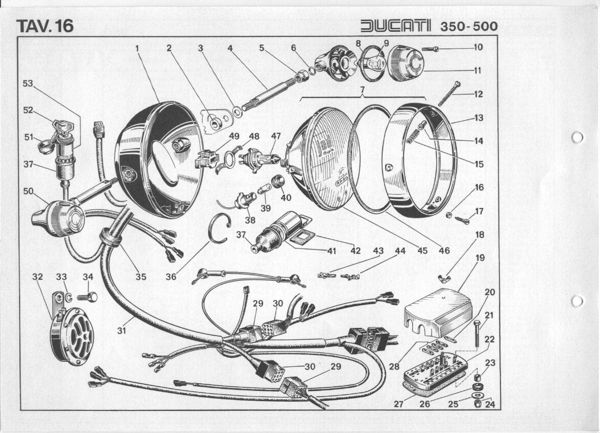

Its a rainy day in Sydney today, and I still hadn't separated the lens from the reflector, turned it upside down poured paint stripper till the lens was halve filled and let it sit for a few hours. I used a wooden dowel to push the glass from the inside and with no force what so ever the lens separated nicely.

Another thing how many different styles of Aprilia headlight shells are there?
The one that was sent to me is not rounded at the rear but it has two dent like dimples either side of the rear dome, the chrome rims fits correctly as does the reflector unit , is this of some other bike?

Post by cafe*racer »
Martin, that is off a 350/500 GTL. I believe its sucessor, the GTV, also used the JOD lens in a slightly different bucket.
