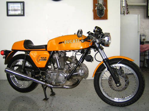

Guys,
I am looking to buy this '74 750 sport. The numbers check out are in our registery. What do you think of the authenticity of the bike? From a value perspective which year '72, '73 or '74 is the most to least valuable or are they all the same?

Looks a pretty correct 74 to me. The picture isn't detailed enough to have a good look at it.
From a value perspective, I'd say the black case 73's are becoming slighty more desirable than the 74's, but I'm not sure that actually translates into a difference in the price. Condition and completenes is much more significant. Genuine 72's are very rare. Difficult to put a price on them as they are very rarely seen for sale (and not easy to verify as a genuine Sport, too, I'm told)

- It looks like it has aftermarket horns on it.
The tail light and mount is US spec.
Whatever is situated just above the horns isn't factory - perhaps some different coil arrangement?
If those headlight ears are chrome they should be verlicchi matt black
The headlight doesn't look quite right, but it may just be the photo.
