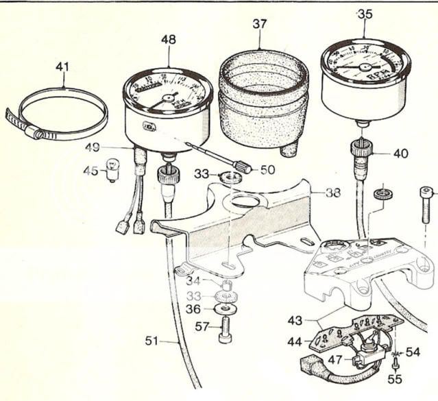

Hi All,
Wondering if anyone can possibly help with a photo of the underside of an 860 GTS dash unit ? . Alternately, a good description may give me enough to go on, but I currently have just the metal top that mounts to the handlebars. Not sure if they have an underside/backing panel, but it has 2 small screw holes underneath, so maybe its just a metal plate or a piece of circuit board to hold the LED.s that screws up inside.
Any help much appeciated
Rick.

Does this help, Rick? Are you missing part # 38? And the two small scew holes could be for the two screws, # 55?

Brilliant, exactly what I needed ! ........No, not missing part #38, it is part # 44 that I didnt have. As I suspected,it appears to be a piece of circuit board with the led's fitted that screws up into the back of the main cover plate #43.
Now, if I can locate someone who sells just that replacement part #44 I'm on my way. ( Dont need the City/Country horn )
You must have some excellent reference material Craig, cause I couldn't find a detailed photo like that.
Just to be a further pain, does the parts manual list the Ducati part number for #44
Thanks again Craig, you've been a huge help.
Kind regards
Rick

rwhc80 wrote:No, not missing part #38, it is part # 44 that I didn't have ...

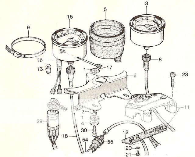

Ah ha! Part # is 0799.38.215, if you have an Aprilia dash (which is the one in the scan above) ...
or 0799.38.216, if you have a CEV dash - which looks like this (I think the main difference is that there's no horn switch in the CEV dash):

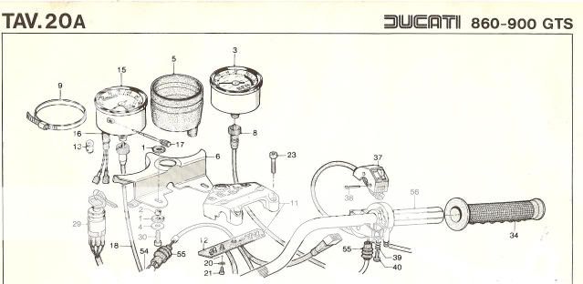

rwhc80 wrote:You must have some excellent reference material ..
Both scans are from the 860/900 GTS parts book, Rick. (This time, I haven't cropped the header from the top of the page .. :) )
Craig, always glad to be of assistance :vroom:

Close up of the CEV dash (a bit clearer) ...

You have been a huge help ! ....... I think I actually have both types of dash. Definately have the Aprilia type with horn and another without. On your scanned page, both dashes have a toothed out key hole. My Aprilia dash has it. but my other dash does not. Maybe they changed slightly along the way .
