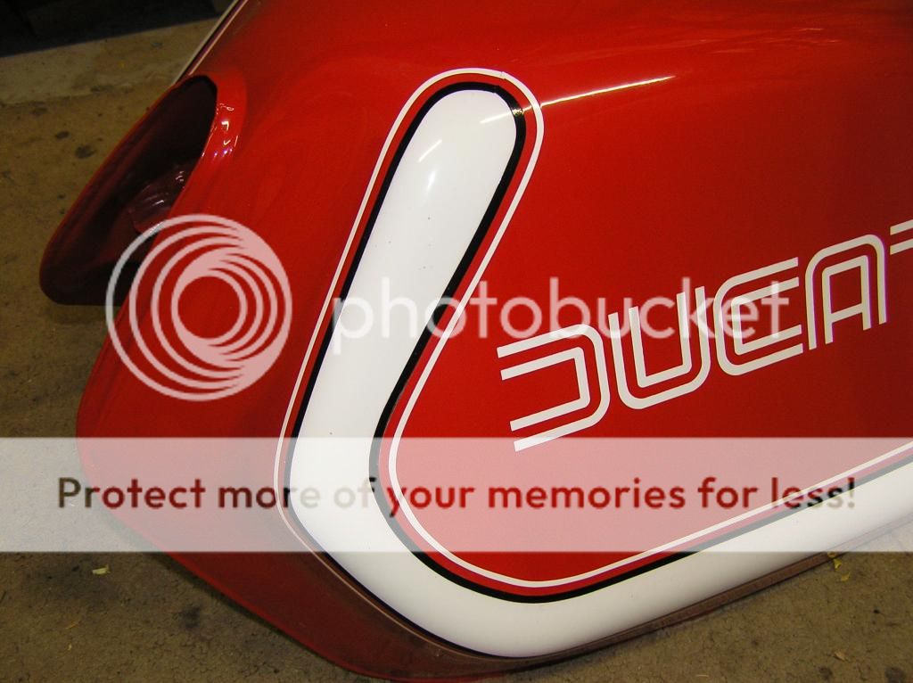

The problem I experienced was the uneven dimensions of the seat base on my 78 Darmah, not the side covers or frame. One side of the overhang of the seat base was near 5mm longer than other. I used to make surfboards, so was familair with f/g and sorted that out to get an nice even 5mm gap. Even with that, the tank end points were not totally symmetrical either.
The finish when new was pretty ordinary. Here's an original tank I have that has never been put on a bike. Check out the pin striping detail at the top of the stripe loops...
Must have been after some lunch time Chianti
