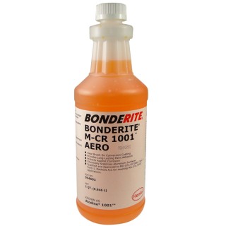

Post by geodoc » Thu Sep 08, 2016 7:45 pm
I treat all bare aluminum with Alodine conversion coating. 1001 is clear, 1201 results in a brownish color finish. Terrific at preventing corrosion.
http://www.skygeek.com/henkel-alodine-1001.html
